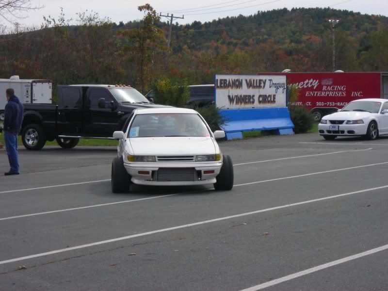

I have been shopping around looking for a set of rims and tires for my colt (89). I stumbled upon some cheap race type rims, however they have a low offset. I know i could fab something up to correct camber, but does anybody know any advantages or disadvantages to running a low offset rim?
here is the rim brand:
Diamond Racing Wheels
contrary to the picture, and the euro hotness; With what they have in stock, it would be in a form of a 15x7 wheel, with a 4.5"(+12) backspacing. Or if i can go to a 15x8 with a 5.5"(+25) backspace, if they fit. OR I could just ask to get a custom rim made for 5.5"( +38 ) of backspacing, but this is why im asking first what would be the disadvantages and advantages to a low offset rim.

A +12 or +25 will not fit on a CSM. It will stick way out past the fenders and look stupid, and no amount of camber correction will fix it. If you can get a custom backspacing in a +38 offset then that would fit, but it wouldn't look like the wheels look on that VW in the picture.
The major disadvantage to running too low of an offset is mostly the wheel not fitting on the car and looking stupid. It also puts more stress on the wheel bearings.

so im confused, the +12, and +25 won't fit, but will give the car a stupid look with uncorrectable camber? This statement inquires that they had been fitted to be seen like this! But i understand what your saying.
I'm not caring so much about the getting the look of the VW, just don't wanna pay the little extra to get them "custom" made. and the way it looks is an opinion.
thanks for a little bit of info. does anyone have any stupid looking pictures of a colt with low offset wheels :lol:

Yeah, don't do it.
89' Mitsubishi Mirage Turbo.
PostPosted: Tue May 06, 2008 5:36 pm
Yeah, don't do it.
LOL, that is the exact picture I was thinking of.
PostPosted: Tue May 06, 2008 5:44 pm
Yeah, don't do it.
Rotflmfao.

RWD offset on a FWD setup = FTL!! :butthead:

I will have to grab a Mustang rim and bolt it on to see just how far it hangs out .
The picture I posted, the wheels were from a Mustang. Also Accords and 240SX's have the same bolt pattern. And maybe Miata's?
