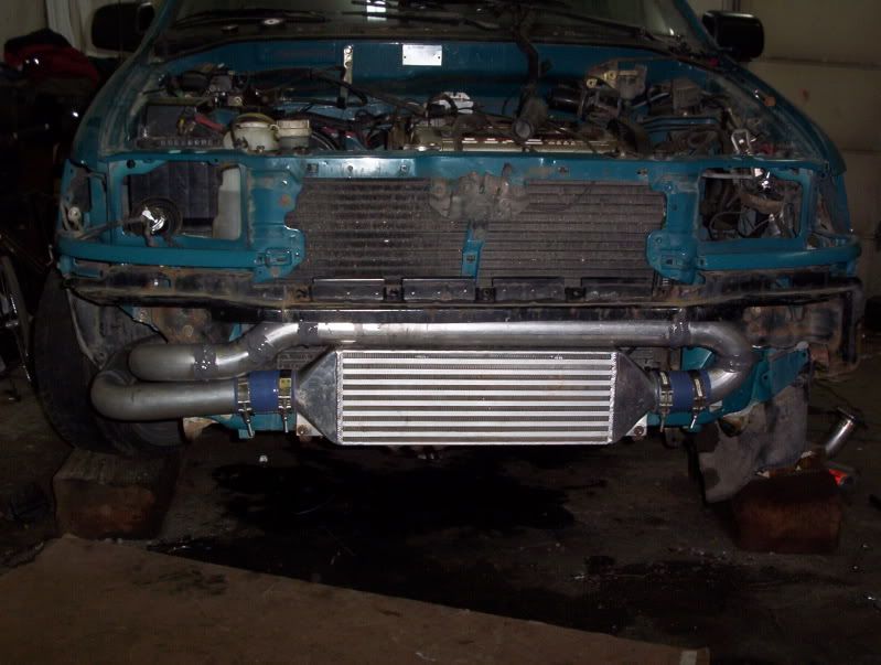

Threw some 17s on to see what they look like, they look stupid but should look good with taller rubberImage
Exhaust is all done 2.5 from turbo back mandrel cherrybomb resonator in the middle kind of a fun job ok not really
Started on the intercooler. This is going to be the biggest job of all, and so many ways to run the piping. I really really dont want any piping where you can see it. The intercooler is a very good fit too. It could be a little longer or shorter, but 3 inch thickness is perfect, no it is not a 10 mph bumper anymoreImage

My exhaust on my sedan is made the same way except I used a 3" glasspack and 3" pipe to the bumper with the 2.5" downpipe. Sounds awesome, doesn't drone and is quiet enough to stay out of trouble.

 Post subject: Re: Vista time!
PostPosted: Tue Apr 12, 2011 9:46 am
Very nicely done! My first FMIC on my Laser RS was piped in almost the exact same manner. Your piping looks far better than what I used.
