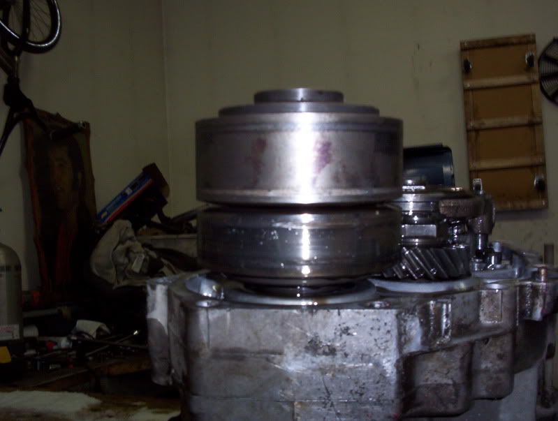

it turns out the transfer case was the root of all the problems here. I suspect it was run out of oil at some point. It is SHOT. The blown t case seems to have caused a ripple effect, the center diff has a lot of chipped teeth and some of the gears are chipped as well. All in all though the trans is not bad. It would probably have lasted a long time with the chipped teeth, bearings all look fine.Image

Too bad you are too far away, I actually need a bad transfer case :).

The van gears are dsm gears for sure. The 1st and 2nd gen gears can be mixed and matched as well. I should have known this already, my race colt is a 92 trans with jdm evo gears in it. I took a look at the evo case and it is a 2g case(has the 2g mount holes). So there you go. I have a spare van trans and i didnt even know it.
I have no idea why the van vc is smaller. Maybe its a weaker awd effect, for milder street manners? It does seem silly that they wouldnt just use 100 percent dsm parts, cant see the reasoning.
