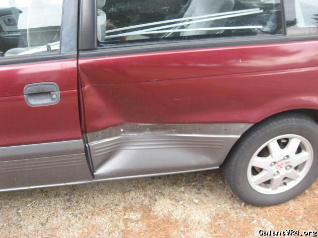

Well there is some good news and some bad news. Bad news first, I went to help my buddy the other night at his shop and shortly after I got there he had to run a friend of his home that lived down the street. He was helping him do something with a part to his car with a cutoff wheel. After they fixed it they left. My buddy comes back in 30 seconds later and says "we just picked up another job". I said "oh yeah, what?" and he says "your wagon, I just backed into it by accident and tore the whole 1/4 panel up". :grin:
When I went out he shined his headlights on it and my heart sank. Kinda hard seeing her like this after all of the work I've put into it. At 1st we were just going to fix it but then he decided to just turn it in on his insurance. The cost of buying a new 1/4 panel and putting it on was over 2K so State Farm totaled it out. They gave me almost $1500 plus I get to keep it. It will have a salvage title but who cares? I'll end up straightening it, was planning to paint it in the near future anyway. Just a minor set back but the money will come in handy. Been wanting to build a nice big shelter off the back of the house over the concrete pad I had poured last year.
Here's what she looks like. :cry:

PostPosted: Tue Feb 19, 2013 3:18 pm
damn what did he do floor the other car that hit u? that suckes but at least u can fix it urself with your new found shade area lol.
PostPosted: Tue Feb 19, 2013 10:48 pm
He was barely moving. The bumper on his Dodge Dakota shows no damage at all. Dakota 1, Summit 0 :lol:

Actually it already looks much better. It was nice out the other day so I removed the rear seat and the interior panel behind the quarter and was able to push most of it back out. Trying to decide it I want to bother with straightening it or cutting another one off a donor and welding it in. Not a big deal either way, I can do the work myself, just need to find the time.
