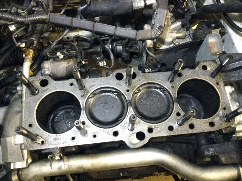

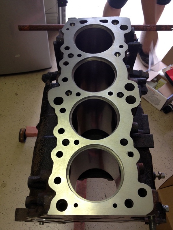

Got the trans back from Shep and was in the process of breaking it in when I blew an IC hose on the freeway. I limped it off the freeway with no boost and immediately discovered which hose had blown. Managed to get it back on and when I started the car I noticed it felt like it was off a tooth timing wise again (aka. sounded like it was missing/running on 2 cylinders). This time, however, it was grossly underpowered until I got high up in the RPM's and even then it didn't feel right.
After sitting for a while I finally got around to doing compression and leak down tests. It looked as though I had 0 compression in the middle 2 cylinders. Had a friend come over to check things as well and he said to pull the head. Pulled the head and found a blown head gasket across all 4 cylinders. Based on where it blew you'll understand why it wasn't burning any oil/coolant or over heating and why it wasn't totally evident this was the problem.

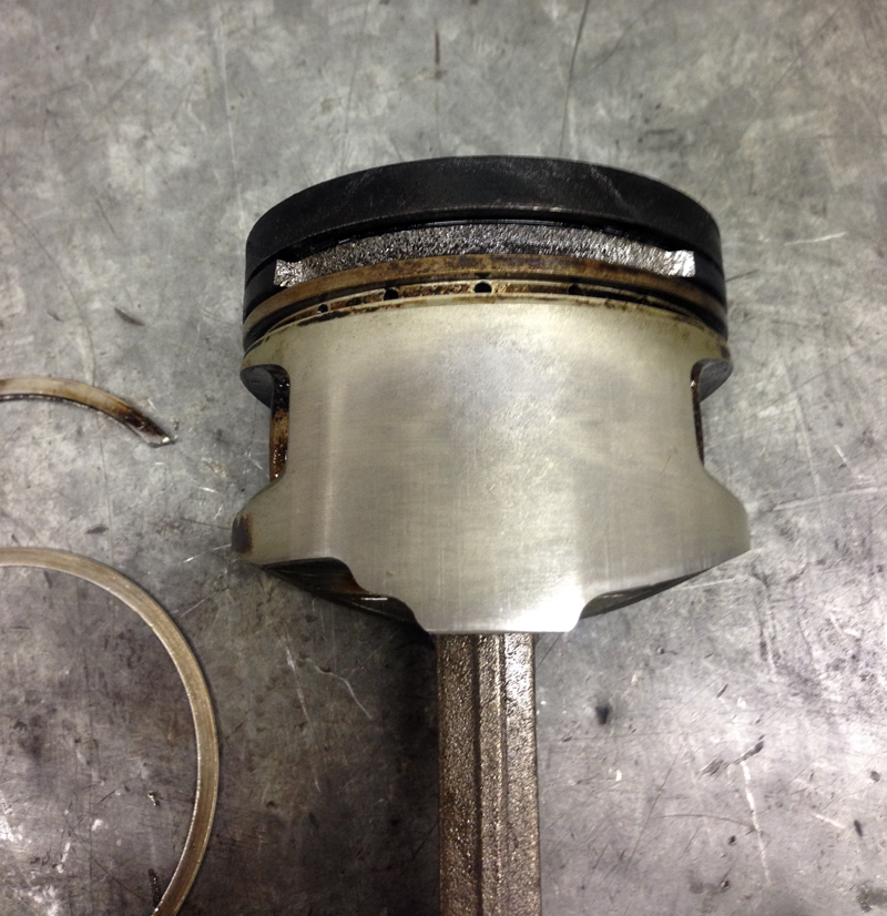

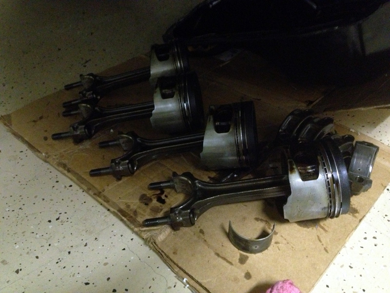

Since the cylinders didn't have much cross hatching left and this motor probably has 100K+ I figured it would be good to do the rings and bearings while the head was off. So I pulled the pistons.
Upon closer inspection of the pistons we found this....on all 4!
Motor was dropped off today at the machine shop so I'm waiting on them. Plan to put in upgraded rods and forged pistons and put her all back together. I would say "more updates in about a month" but don't want to hear you guys talk any more shit. :D

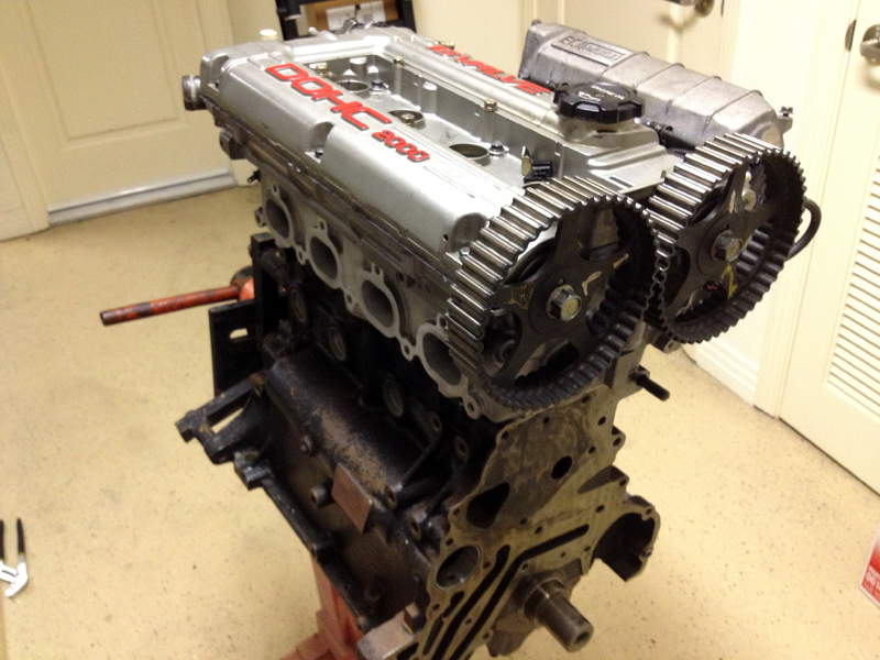

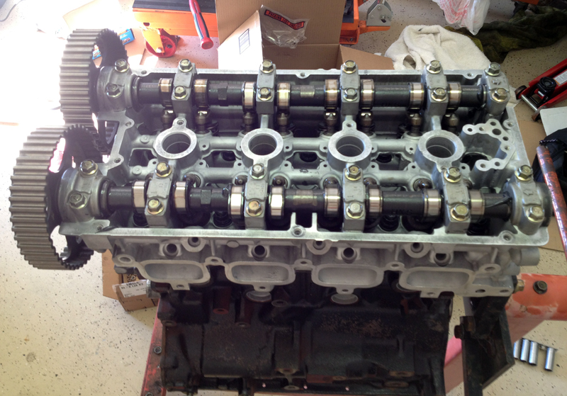

Round 9: Back in the Saddle
The progress has been slow over the past few months but a lot has changed so I figured it was time to post an update. The engine has been built and is back in the car and broken in. I went to the 1/8th mile drag races a few weeks ago and thought I broke something in the drive train but the culprit was probably my driving and an overheated clutch. Everything is back together (never took the clutch out to inspect it) and the car seems to be operating ok. Heading back tonight and will report back on the results. Hoping to get some in car video this time!

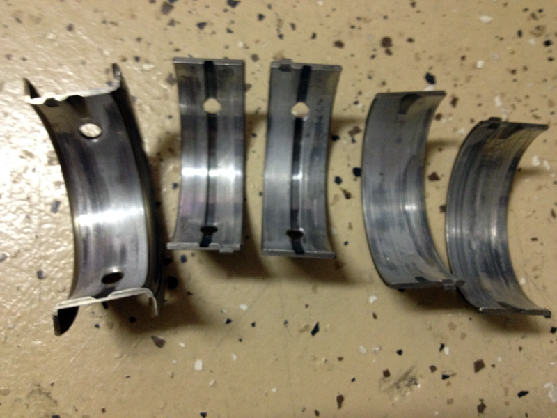

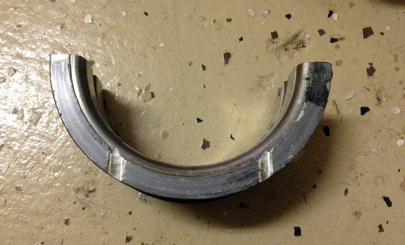

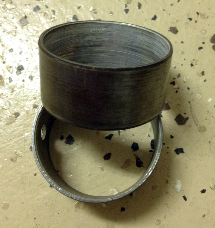

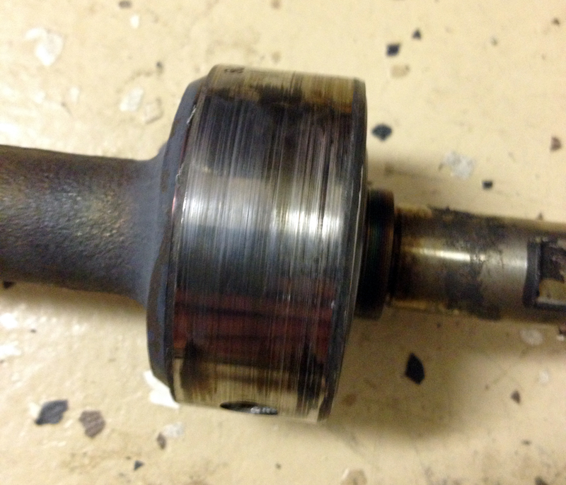

Here are some shots of the bearings that came out of the car. I wasn't pleased to find the cracked ring landings but it turned out to be a blessing in disguise given the shape these were in. Would have been horrible to put the motor back together only to later have a bearing failure!
*Balanced Shafts were removed/deleted. Regardless of condition this was the plan all along. Because Race Car!!

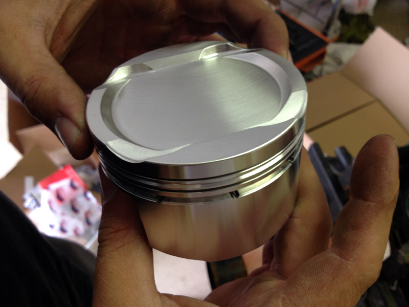

Forged JE Pistons

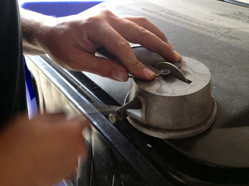

Filing Rings and Checking Clearances

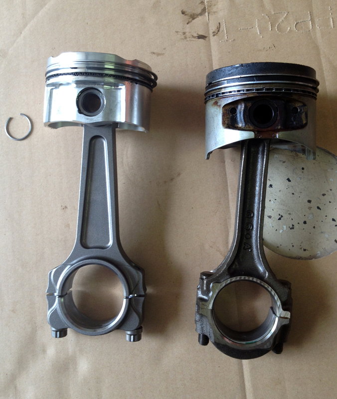

Stock VS Aftermarket (Manley Rods)

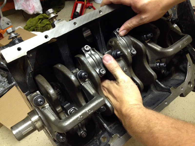

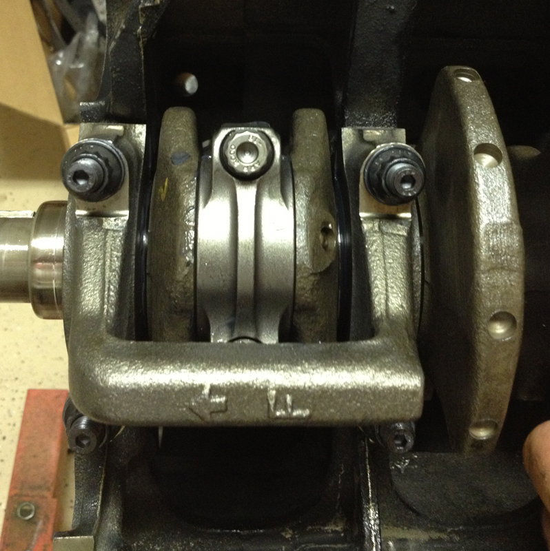

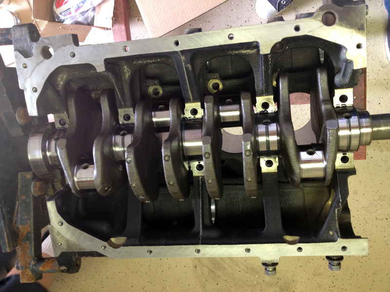

Crank Install and Checking the Rotating Assembly Clearances (ARP hardware all around!)

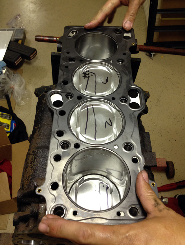

Checking Headgasket Clearance (Cometic)
*Yes, that's a penis on my pistons. Big thanks to my friend Nick who helped with the assembly and drew that on there!!!

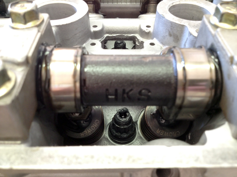

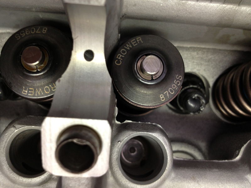

Crower Springs/Retainers & HKS 272 Cams
